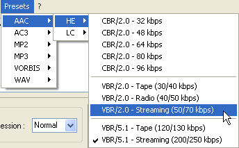

The easiest way to get on the way is to use one of the existing encoding presets:
Select
one, then press the Start Processing button and you're under way.
Note that the presets are divided into two sections: HE and LC, corresponding to HE AAC and LC AAC respectively. If you have standalone compatibility in mind, better check if your device supports HE AAC. For PC playback, you can safely use HE AAC.

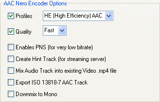

Finally we have the AAC Nero Encoder Options:
Check
Profiles to select between the HE and LC AAC profile. AS
previously mentioned, not every hardware device can handle HE AAC, but if it
can, HE AAC allows for lower bitrates at the same quality than LC AAC.
Check Quality to select the encoding mode: Fast uses a new encoding engine whose results may surpass the results of the High mode. Despite what Fast might make you think, encoding speed is the same for both modes.
The other options should not concern you. Export ISO 13818-7 AAC Track allows you to get a raw .AAC file rather than an AAC track inside an MP4 file.
Downmix to Mono would enable mono downmix, but if you need this, better active it in the BeSweet options instead.

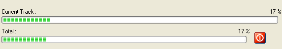

All the remains to be done now is press the Start Processing button. BeLight has a nice progress bar to keep you up-to-date with the progress of the encoding session:
