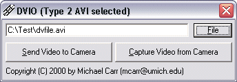

DVIO is very easy to use, and it does not have many options. That means there's not much you could do wrong ;-)

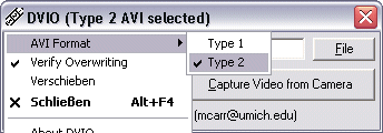

Connect your camcorder to your PC with the firewire cable, and set your camcorder to play mode. Select the location and filename you want to capture to by clicking the File button. Open the DVIO's system menu by clicking on the small logo in the upper left, and select the AVI format you want to create, either type-1 or type-2. Type-2 files are compatible with Video for Windows (VfW) applications like VirtualDub, whereas type-1 files are a few percent smaller. Which one you choose mainly depends on what the software you are going to use later on can support. Click on the Capture Video from Camera button, and the capture process starts. Wait until you've got everything you need, then stop the capture. |
Note: You may use type-1 with VirtualDub as well, but you can't directly use the audio. If you want to process only the video in VirtualDub, there's nothing to do but ignore the warning message you get when opening a type-1 file in VirtualDub. If you want to process the audio, too, you need to extract it as a WAV file from the DV type-1 AVI file using your video editing software, then open the WAV file in VirtualDub via Audio > WAV Audio. Of course you may process the audio separately outside VirtualDub as well, e.g. using BeSweet.

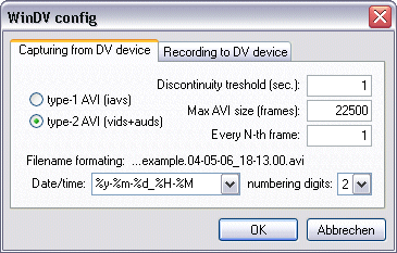

Make sure your camcorder is properly connected to your PC via firewire. Set your camcorder to play mode. First click the Config button to set the desired AVI file type. You may choose either type-1 or type-2, depending on what the software you'd like to use in the later steps can support. There are some other settings you may wish to modify, e.g. the filename formatting using date and time placeholders. If you want to capture to a single file, you should change Max AVI size (frames) to a very high value, like 999999. Confirm by clicking OK. |

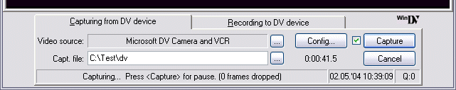

In the main dialog, make sure you selected the Capturing from DV device tab, and select the target file by clicking the the ellipsoid button behind Capt. file. It may be necessary to select the Video source, too.
Check the small checkbox before the Capture button, then click the Capture button and watch the "frames dropped" display in the statusbar. It should stay at "0 frames dropped", but sometimes there may be a few drops in the beginning. If there are drops throughout the capture process, then there's probably something wrong with your hardware or the operation system settings, as this should not happen. Click the Capture button again to stop capturing.
