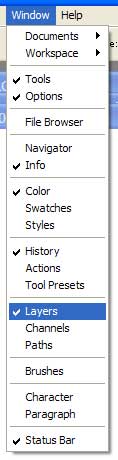

The layers window looks like the image in Figure1. If you do not see it displayed then it probably just means that it got closed somehow. To get it back, click on the "Window" menu item and select "Layers" (Figure 2). Probably the best way to think of layers is as if they were clear "transparancies". Let's say you had 2 transparancy sheets. One with some words you had written with a red pen. The other is completely black. If you put the completely black one on top of the lettering, you would not see it, right? Conversely, if you put the lettering on top of the completely black one, you would see red lettering on a black background. This is the same way layers work in Photoshop, only they are much more versatile! A feature that is worth mentioning here is the small "eye" icon beside each layer in the "layers" window. If you turn the eye "off" then that layer is not displayed. It doesn't mean it is gone, it is simply not displayed. We'll learn some more about that later. The next

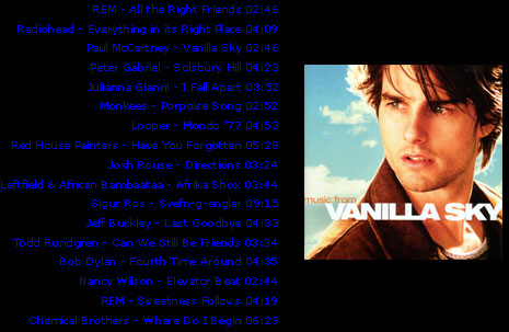

Designing the buttons... Now there are two things you want to keep in mind when you begin creating your buttons (especially if they are text!). First, is do NOT use anti-aliasing. This is a feature which blends text on the screen. It's great for pictures and stuff on the computer but you don't want it for your buttons! It creates areas around the buttons which are difficult to mask and you will end up with a worse result in the end. The next thing is do NOT make your text too small! When I first started working on this idea, I figured I would have a list of all my songs on the screen (Figure 3) and just select which one I wanted to hear. |

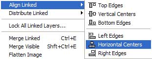

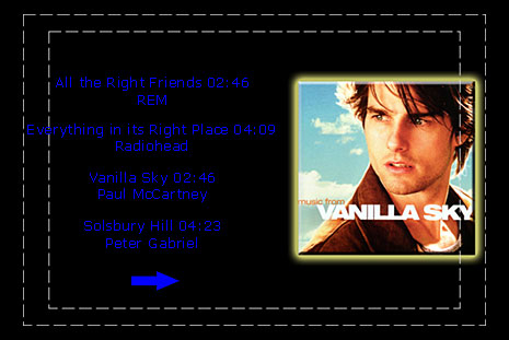

This turned out to be a bad idea because, while it looked great on the computer, the text was far too small to be displayed properly on the TV. I recommend using a thick font at around 12pt or higher (The bigger, the better!). Although I would have preferred having it all on one screen, I opted for four songs per screen to allow me to use a bigger font. (Figure 4) Now another thing you will want to become proficient with is arranging your text layers once you have them. How do you line them up? What if I want to move all of my text at one time? There are tricks for doing this in Photoshop. As in my example, I wanted to center each text layer but I also wanted them to align themselves to each other's center point as well. This is done the same way you would move all of the text at one time. You temporarily "link" the layers together in your layer window. If you are on a particular layer, it puts a paintbrush beside the eye in the layer window indicating that is the active layer to draw on. You'll notice that box is blank for the other layers. Click on this box for each layer that you want linked. It will display what looks like a small chain indicating the layers that are now linked. |
Once your layers are linked, you can control them as one. The first thing you want to do is center them. This is done by aligning them via their horizontal centers. (Figure 5) Now those linked layers will all be aligned. You can also move the linked layers as if they were one while they are in this linked mode. This is done simply with the "move tool" located on the main toolbar. It looks like this: Once you have everything as you want it, go back and un-link these layers. Also, before you finally save the file, make sure to toss out the "safe area template" layer. You'll see a trashcan at the bottom of the layers window that you can drag that layer to. You can choose to leave it out when you import into ReelDVD but if you do it here, you are sure not to forget. ;)

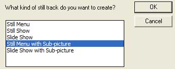

Creating the menu and buttons in ReelDVD... You import the file you just created just as you would any other asset in ReelDVD. When you do this, it will ask you what you want to do. (Figure 6) Since we are wanting to create buttons out of our layers, you should choose "Still menu with subpicture". Afer you click "OK", you will be presented with a screen showing you all of your layers and what the subpicture will look like. You will easily see if you've made a mistake by inspecting everything in this area. Once you are satisfied with the way things look, click the "OK" button and your new menu will be imported.

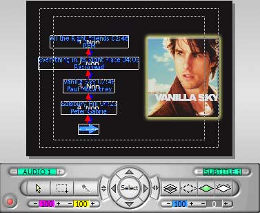

You are then free to set your "selection color" and "action color" as you see fit in the bottom right window. (Figure 7) My example shows the "selection color" that will be displayed when a button is selected. Now all you have to do is assign your buttons to something! If you look at the asset on the main storyboard, you will see a small arrow pointing left. When you click on this (it sets the CMD action) and drag it to another asset (a movie, another menu, etc.) then it will pop up a window that looks very much like your main window shown in Figure 7. It will ask you which button is to perform that action. Simply select the button you want, and you're done! Now that was quick and painless, wasn't it? hehe :) Creating the menu and buttons in Scenarist... Well, as we all know, it's a sort of "love-hate" relationship with Scenarist. She's really not all that friendly but for all her "bitching", she's still the most powerful out there! ;) There are two different ways you can attack the problem of doing this in Scenarist. The first involves creating the menu in ReelDVD as we've just explained.
