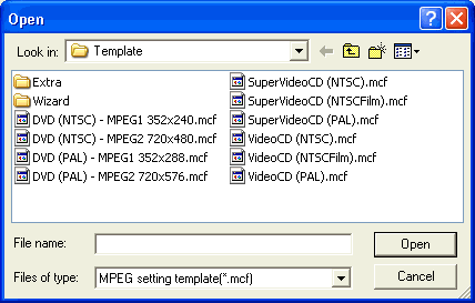

you have to select the appropriate profile. Here's the selection matrix:
23.976fps: Select SuperVideoCD (NTSCFilm).mfc for SVCD or VideoCD (NTSCFilm).mfc for VCD.
23.976fps & NTSC -> PAL Conversion: Select SuperVideoCD (PAL).mcf for SVCD or VideoCD (PAL).mfc for VCD.
29.97fps: Select SuperVideoCD (NTSC).mfc for SVCD or VideoCD (NTSC).mfc for VCD.
25.00fps: Select SuperVideoCD (PAL).mcf for SVCD or VideoCD (PAL).mfc
for VCD.
If you're doing the NTSC -> PAL conversion there's another thing you need
to do right now. Press the Load button again, go into the Extra folder and select
the unlock.mcf profile. Then you can change the Stream type in the bottom part
of the main TMPG window to Video only as you already did the audio encoding.

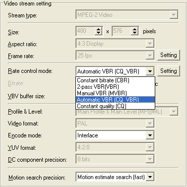

When doing an SVCD also press Settings again:
Go to the Video tab:
Either
select Automatic VBR (CQ VBR) where you can change the quality parameter (50
is good, more is better but don't go above 65 and keep in mind that better quality
equals larger size) and the minimum (should be left at 0) and maximum (don't
go higher than the default of 2520).
Or, you can go for 2 pass VBR encoding where you can set an average bitrate
that is lower than the max bitrate (don't go over 2520) and a minimum bitrate
(leave it at 0). I would set the average bitrate somewhere between 1500 and
2000 depending on your quality needs.
