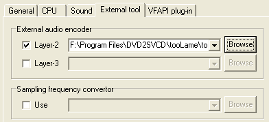

Once you started up TMPG go to the environmental settings:
Then go to the external tools, check Layer-2 and choose toolame.exe. Note that depending on the toolame version you have it may not be called toolame.exe but something else. TMPG requires that the file is called toolame.exe so if it's not, rename it to toolame.exe.

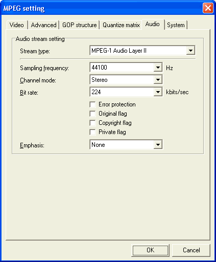

Then configure the audio options by pressing the settings button, then go to the audio tab.
VCD and
SVCDs require 44.1KHz sampling rate. VCD requires 224kbit/s whereas for SVCD
the bitrate can be lower. Leave the rest of the options unchecked.
