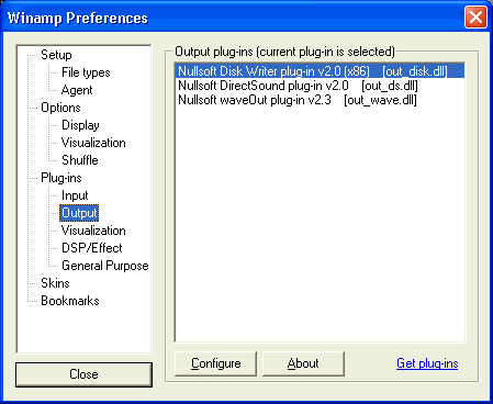

DVD2AVI will have extracted your audio to a file that has a name like this: test MPA T01 DELAY 0ms.mpa. Change the extension to .mp2 then load the file in Winamp (double clicking on it in Explorer will do just fine). Then press Control-P to go to the properties of Winamp.
Click on Output, then select the Nullsoft Disc Writer plugin and press Configure to set a path for the output file.
Then press close and start playing. Winamp will rapidly go through the whole file without actually playing anything but you'll hear the harddisk working all the time. Once it's done, you can close Winamp again, but don't forget to set the Output plugin to Nullsoft waveOut plug-in before you do that or every file you will play from this point on will be decoded to a wav file instead of being played.
