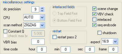

  Then we have the miscellaneous settings:
  dc precision should match your source. DVDs normally are 10 bit. Leaving
  the CPU setting at AUTO will ensure that the proper CPU optimizations
  are enabled for your CPU type.
Leave the scan method at ZIGZAG for progressive content, and set it to ALTERNATE for interlaced content. When dealing with interlaced content, you also have to configure the field order in the interlaced fields section. This section only becomes active if you check interlaced.
If you check Constant Q, you enable the constant quantizer mode - the bitrate settings will become disabled. If this mode is enabled, you can check check max br and the maximum bitrate field will become active again, so you can enforce a maximum bitrate.
Using the VBR bias, you can modify how bitrate is allocated - the lower the value the faster the bitrate can change (so 0 is full VBR and 100 is full CBR)
After a 2 pass encode, the restart option can be used to run the second pass again with different parameters, without having to redo the first pass as well. To do this, check restart pass 2, then click on get restart info , then you can change all the parameters not grayed out. Finally press the restart button to redo the second pass.
Leaving scene change enabled will ensure that HC detects scene changes and forces an I-frame at this position to improve quality of cuts. You should also keep VBV check enabled, as it ensures that the video can be properly decoded on standalone players. Also keep the seq endcode checked.
Checking shutdown will make HC shut down your PC after encoding.
Finally, you can assign an aspect ratio to the video using the aspect dropdown, and change the timecode of the start frame (you shouldn't do that).

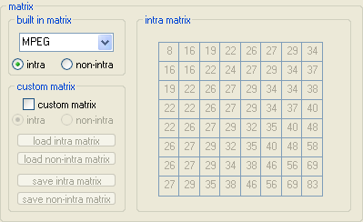

Last but not least, HC allows you to use different quantizer matrices:
HC
  has a number of built-in matrices that you can use for intra (I) and non-intra
  (P and B) frames.
If you check custom matrix, you can load your own matrixes, and the matrix becomes enabled, so you can create your own custom quantizer matrices right here in HC and even save them.
If you don't know what a quantizer matrix is, I strongly suggest that you do not create your own matrices.
