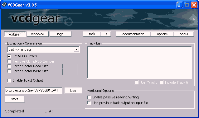

After the copying open the .DAT file in VCDGear
First select dat -> mpeg from the Extraction / Conversion dropdown list and also check Fix MPEG Errors just in case. Then press the Load button and select your DAT file. After selecting the .DAT file you'll have to select a filename for the output file. Then press Start to start the conversion.
Once VCDGear is done close it and start VirtualDub.

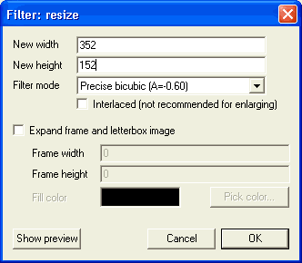

Then set Video to full processing mode (Video -> Full processing mode) and then press Control-F to bring up the filter selection dialogue. There press the Add button and select the resize filter from the list and press OK to configure it:
here you'll need your calculator. Depending on the aspect ratio of your movie you have to put a different height. Please refer to amazon.com or imdb.com to find the aspect ratio of the movie. The rule of thumb here is if it's full screen it's 1:1.33, if it has big black bars it's 1:2.35 and if it has small black bars it's 1:1.85. The width is always 352 and the filter mode Precise bicubic (A=0.60).
1:2.35: 352x152
1:1.85: 352x192
1:1.33: 352x264
Then press OK. Again in the filter selection insertion window you can now press the Cropping button on the left side:
Increase the Y1 offset and Y2 offset until you can see no more black bars, then press OK twice to get back to the main VirtualDub window.
