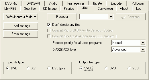

After starting up DVD2SVCD you'll first have to put it in AVI2SVCD mode by going to the Misc. tab.
set Input file type to AVI and select the output file type according to your
desired output.

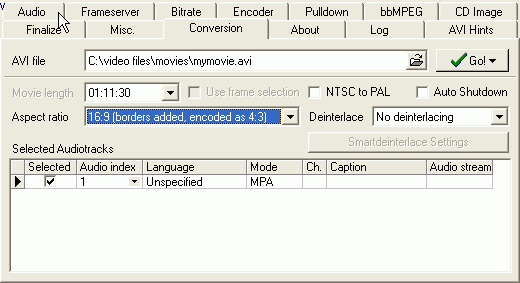

Then go to the Conversion tab.
Press
the button to the left of the Go button to select your AVI input.
The NTSC to PAL option is active meaning that this AVI was made using an NTSC framerate and it would be possible to convert to this PAL. My DVD Player can handle NTSC SVCDs so I won't convert it.
Then the aspect ratio. Depending on the AVI you'll have to change this from the default 4:3 to 16:9. Most DVDRips from 16:9 sources require this change, if you forget to do it you'll end up having a wrong aspect ratio.

have any influence and that there won't be a subtitle tab. Also don't forget
to not change the input and output type once you get to the Misc. tab again.
Once
you press the Go button select Start conversion from the menu. You'll be asked
if you want to continue, press OK.

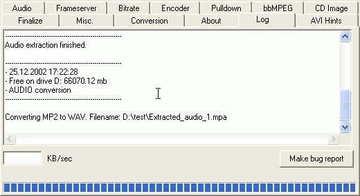

DVD2SVCD will change to the log tab where you can keep track of the process.
Once the process has finished you'll have one or multiple sets of .cue/.bin
files named CD_Image_File_CD1.cue, CD_Image_File_CD2.cue etc. Now it's time
